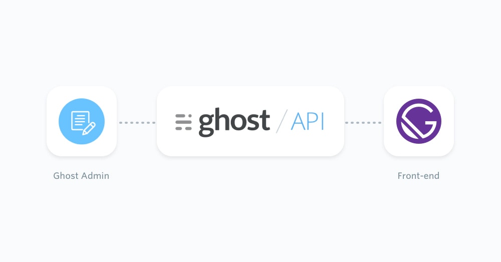

Gatsby works well with Ghost when Ghost is the CMS and Gatsby is the static front-end. Editors keep writing in Ghost Admin. Gatsby reads published content from the Content API at build time, then creates pages from that content. For most Gatsby sites, use the official JavaScript Content API client. It is maintained as part of the TryGhost SDK and works in Node.js during Gatsby builds. Use the Admin API only in private server-side code, such as an import script or publishing workflow. Do not expose an Admin API key in Gatsby browser code.
