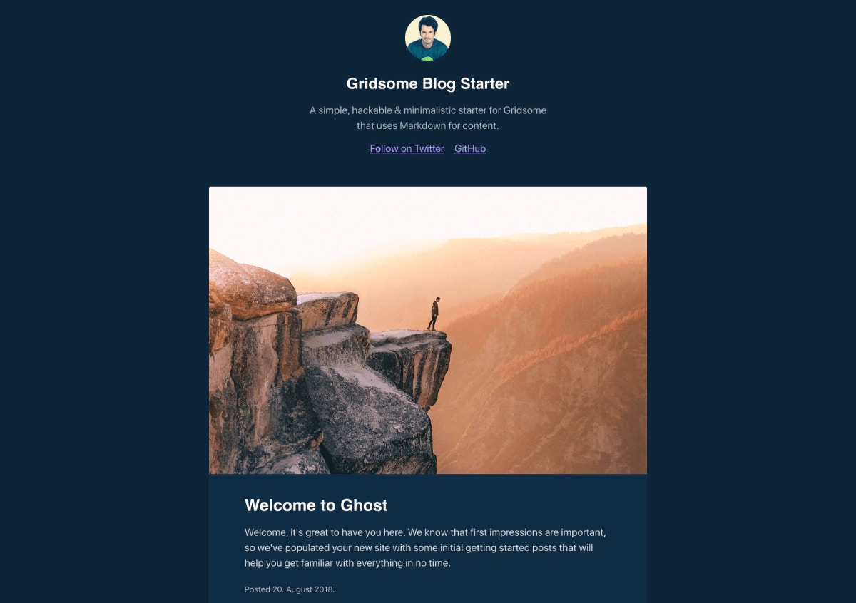

To test everything installed correctly, use the following command to run your project:
Then navigate to http://localhost:8080/ in a browser and view the newly created Gridsome site.

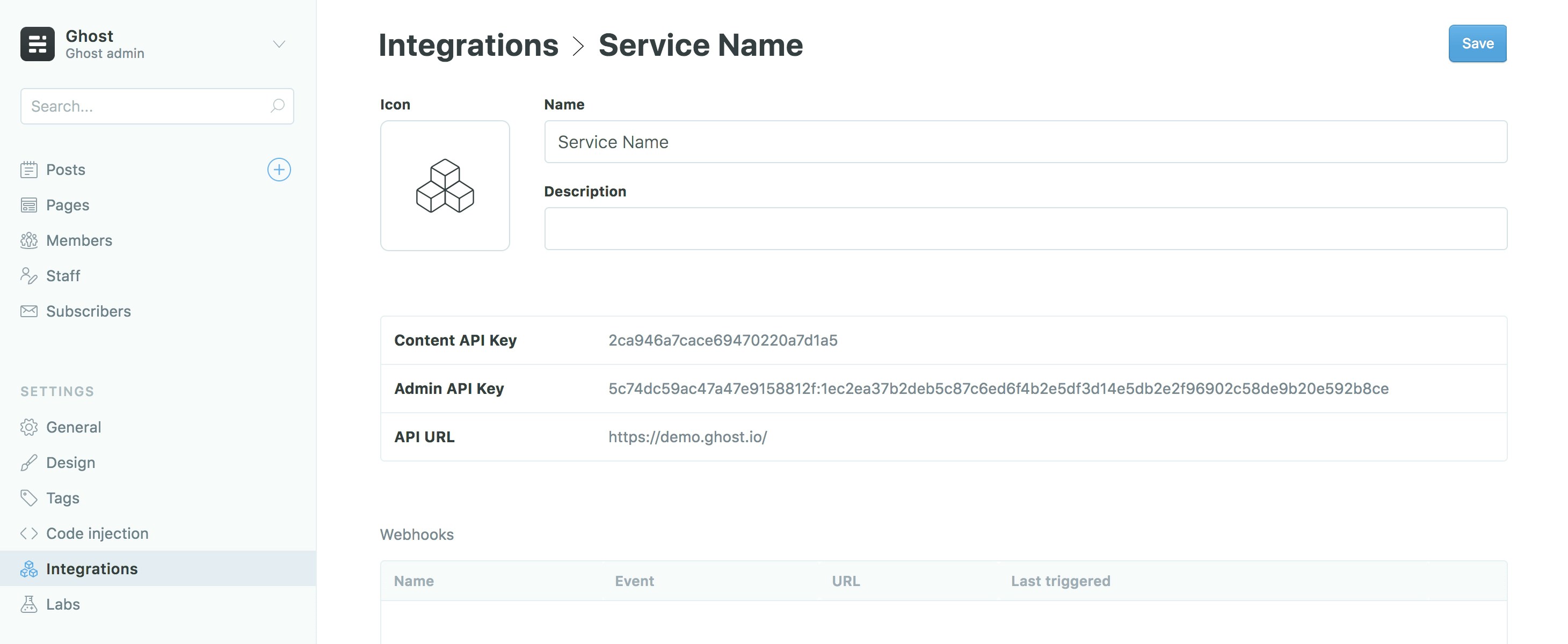

Change the baseUrl value to the URL of your Ghost site. For Ghost(Pro) customers, this is the Ghost URL ending in .ghost.io, and for people using the self-hosted version of Ghost, it’s the same URL used to access your site. Next, update the contentKey value to a key associated with the Ghost site. A key can be provided by creating an integration within the Ghost Admin. Navigate to Integrations and click “Add new integration”. Name the integration, something related like “Gridsome”, click create.
For more detailed steps on setting up Integrations check out our documentation on the Content API. You can remove the @gridsome/source-filesystem plugin if you’re not planning on using Markdown files for your content.

Gridsome automatically reloads when changes are made in the code and rebuilds the GraphQL schema. Navigate to http://localhost:8080/ in a web browser to see the result.
That’s it! Your site now loads posts from your Ghost site, lists them on the home page and renders them in a single view 👏🏼
