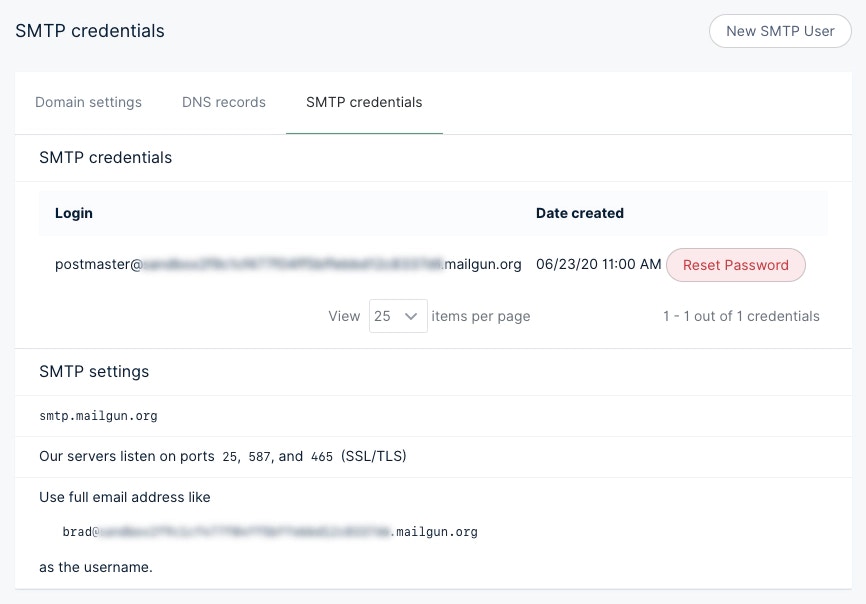

Configuring with Mailgun
Mailgun is a service for sending emails and provides more than adequate resources to send bulk emails at a reasonable price. Find out more about using Mailgun with Ghost here. Mailgun allows you to use your own domain for sending transactional emails. Otherwise, you can use a subdomain that Mailgun provides you with (also known as the sandbox domain, limited to 300 emails per day). You can change this at any time. Mailgun is an optional service for sending transactional emails, but it is required for bulk mail — read more.Create a Mailgun account
Once your site is fully set up create a Mailgun account. After your account is verified navigate to Domain settings under Sending in the Mailgun admin. There you’ll find your SMTP credentials.
Add credentials to config.production.json
Open your production config file in any code editor and add the following mail configuration, making sure to update the values to the same credentials shown in your own Mailgun SMTP settings:
ghost restart for your changes to take effect. These same credentials can be used for development environments, by adding them to the config.development.json file.
Mailgun provides a sandbox mode, which restricts emails to authorized recipients. Once sandbox mode is enabled, add and verify the email addresses you want to send emails to prior to testing.
