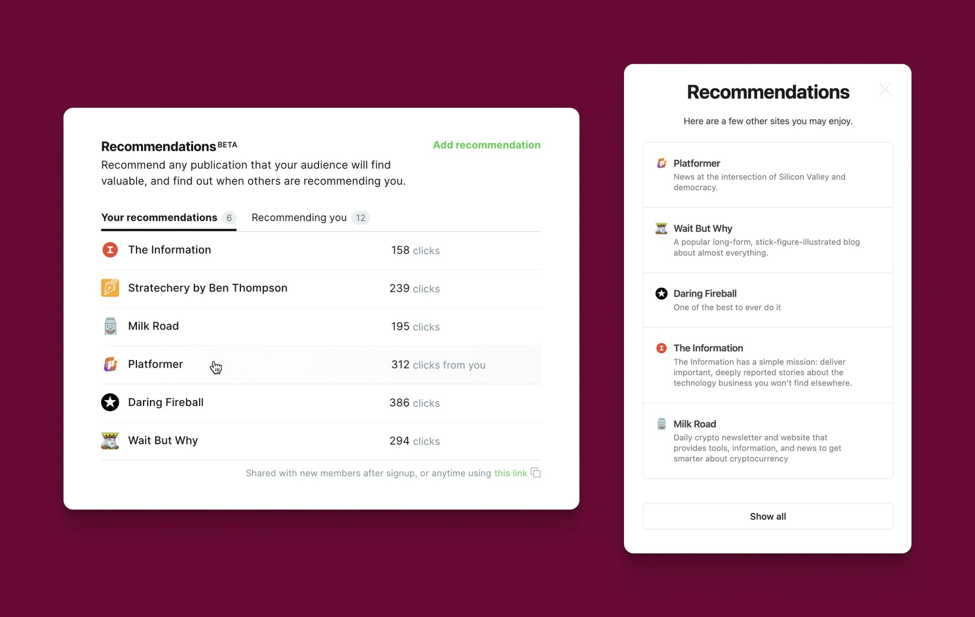

With recommendations, publishers can share their favorite sites with their readers and, likewise, be recommended by other publications. See the Changelog for an overview of this feature.
Under the hood, Ghost’s recommendations feature is built on the Webmention open standard, which means recommendations aren’t limited to any single platform — but extend to every site on the web! Recommendations also make it possible for readers to subscribe to recommended publications with a single click. While this feature is currently exclusive to Ghost sites, we are eager to help other platforms in implementing this 1-click functionality. Contact us if you’re interested in building 1-click subscriptions for the open web! The sections below provide a high-level technical summary of how recommendations work.
See your site’s recommendations
  • The recommendations modal is shown automatically whenever a new member subscribes to a Ghost publication.
  • Visiting https://yoursite.com/#/portal/recommendations will open the recommendations modal. Use this URL as a link in the navigation menu to create a recommendation button.
  • See additional methods for opening the recommendations modal in our theme docs.
